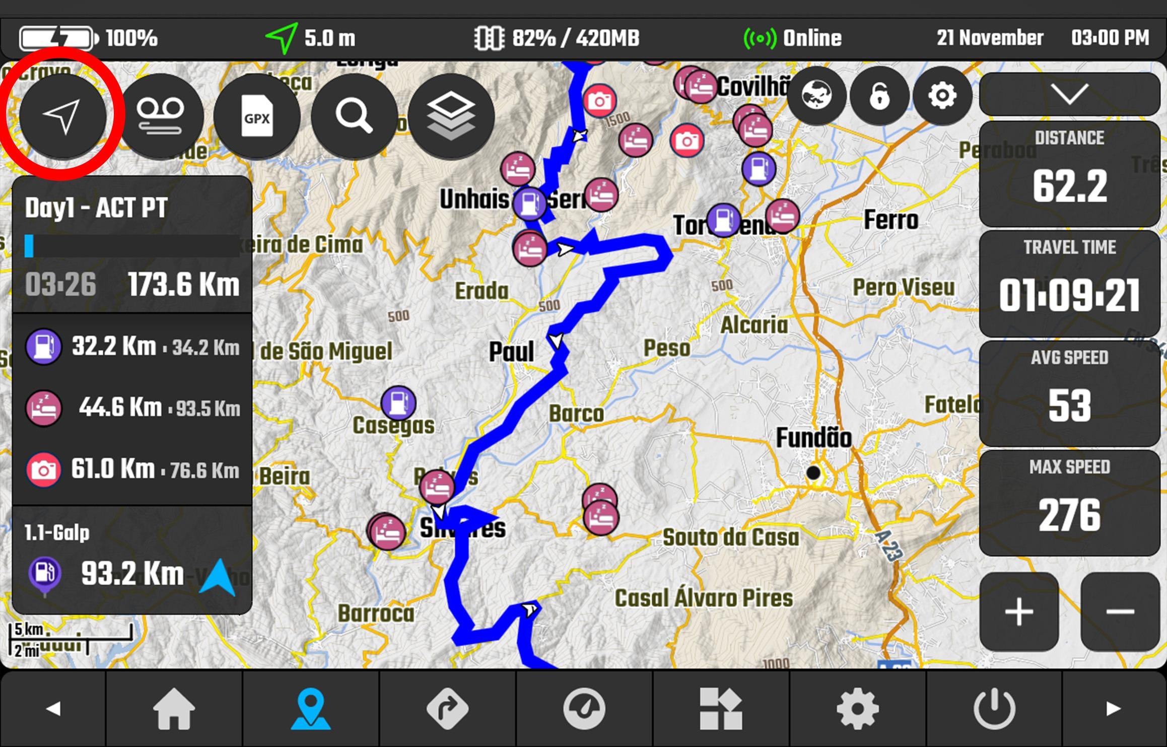

    When looking at GPX tracks in the map section it constantly resets the map to the current location. I recall that there used to be an option to “show on map” but I can’t find it anymore. Is it possible to enable\disable the auto-locate function so that we can load gpx tracks without constantly resetting the map to the current location?

    Use the first top left button in the map view, disable the follow location (empty arrow).
    Even better, if you want to quick view stuff on the map use the small “minimise” button in the top right corner of any dialog 😉
    If you want to close the dialog and the map not move on closing then you should disable the follow location first:
